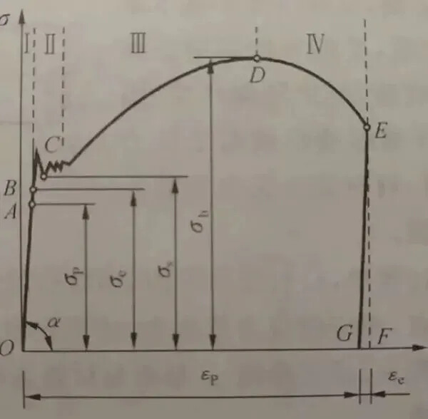

Through the understanding of the above theories on strength and stiffness, compared to stiffness, the definition of strength is aimed at failure under the action of external forces; and the classification of failure types includes plastic yielding and brittle fracture, which leads to the stress-strain curve during tension. As shown in the figure.
The curve in the figure can be divided into four stages:
I. Elastic deformation stage;
II. Yielding stage;
III. Hardening stage;
IV. Local necking stage.
The definition of stiffness is to resist elastic deformation, which occurs in the first stage, and under elastic action, Hooke’s law is satisfied. Observing the calculation formulas for bending stiffness and torsional stiffness under static load, similar to Hooke’s law, it can be inferred that the measurement of stiffness only occurs in the elastic deformation stage.
After entering the next stage, for the plastic strain or residual strain during the tensile process, it will not disappear. Under the stress-strain curve, the stress remains almost unchanged, while the strain increases significantly. At this point, the stress is the yield limit, and for the material, it has entered the plastic yielding failure stage. After entering the hardening stage, the strain increases with the increase of stress, and finally reaches the strength limit. It can be seen that the measurement of strength is between the elastic deformation of the material and the strength limit.
In summary, both stiffness and strength are measured values for the failure stage of parts, and stiffness can be measured by stress, while strength can be measured by deformation. In the strain process, stiffness is in the earlier stage, and strength is in the later stage. Therefore, in the measurement of part failure conditions, as long as the stiffness requirements are met, enough stress can be resisted in the elastic deformation stage, and strength also meets the requirements of the part under such conditions. According to this relationship, there are various designs in actual production, such as shafts in mechanical equipment, which are usually determined by strength conditions first, and then stiffness checks are carried out according to stiffness conditions. The stiffness requirements for shafts in precision machinery are also set very high, and their cross-sectional size design is often controlled by stiffness conditions.
