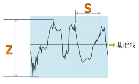

We usually evaluate roughness using a reference line. The highest point above the reference line is called the peak, while the lowest point below the reference line is called the valley. The height between the peak and the valley is represented by Z, and the spacing of the product’s micro-texture is denoted as S.
S value and related definitions:
  • S < 1mm: Defined as surface roughness
  • 1 ≤ S ≤ 10mm: Defined as surface waviness

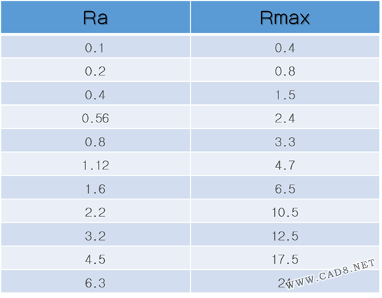

The relationship between Ra and Rmax is detailed in the table below:
Table: Ra and Rmax Parameter Comparison (µm)

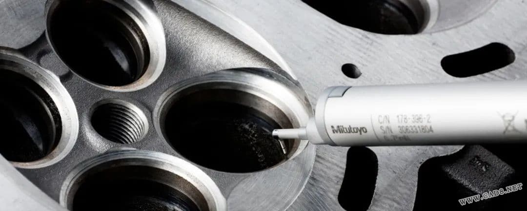

Surface roughness evaluation has become increasingly important in manufacturing industries. To study surface roughness, specialized machines are used, namely:
Surface Roughness Measuring Instruments:

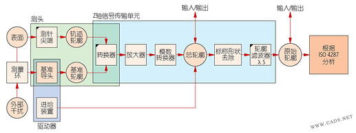

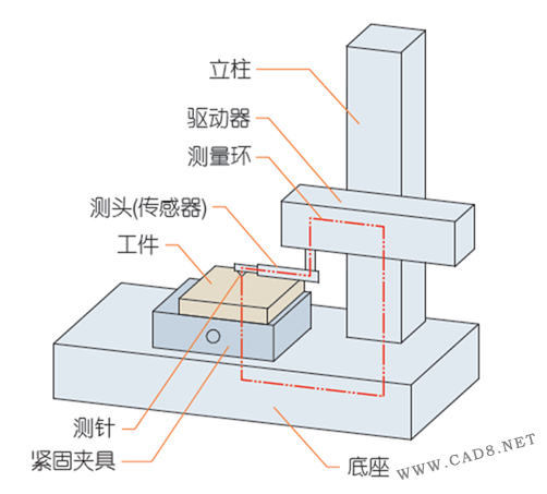

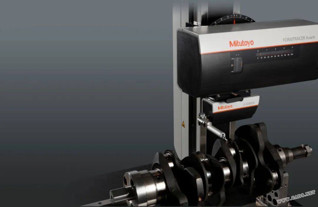

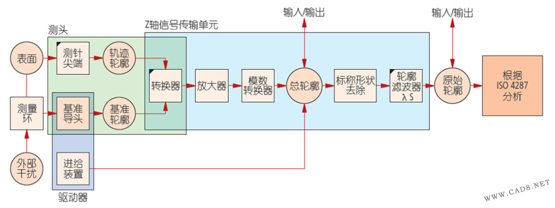

Composite Measurement Machines (Formtracer Avant Series): These devices use highly sensitive diamond stylus to trace the surface, similar to a phonograph’s stylus. The instrument separates small wavelength roughness from longer wavelengths using electronic filtering.

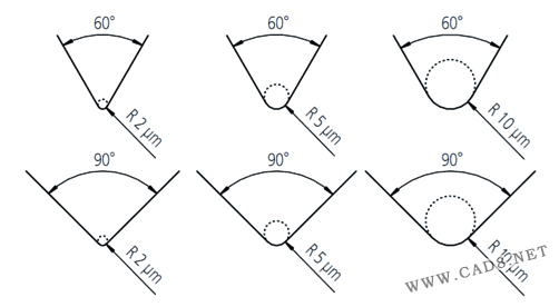

Key Features of Stylus-Type Roughness Measuring Instruments (ISO 3274:1996):
  • The stylus-based measuring instrument diagram and the various stylus shapes are shown below:

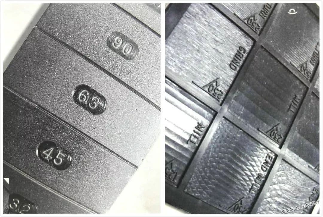

Handheld Measurement Tools: Handheld roughness comparators are often made from nickel via electroforming and are ideal for metalworking. They are effective auxiliary tools. Operators compare the workpiece’s roughness with the comparator to determine the roughness value.
Roughness Comparator: Made of nickel and used for comparing workpieces during metal processing. It is a very useful tool for determining surface roughness by visually comparing the workpiece against the comparator.
